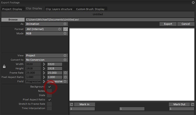

Ive just animated my first scene in TVP and everything has gone surprisingly well and glitch free - however now I'm trying to export I'm having a few problems. The movies I've made ( almost all formats) come out black apart from some frame numbers that I drew on to the layer I'm trying to export (!) and the sound. I've looked for advice online and here in the forum but can't find anything. All my layers are switched on. I've got TVP 11 the professional version.*GLUM*

Do you have "Background" checked in your 'Export Footage Window'?

Brilliant! thanks for the advice Michael- it worked! Thanks so much. Its the smallest things that catch you out!!! Long time no see - hope you are well. You look well in your profile pic. :D

Yep, you need a background layer or to click that box. I was confused for a while when I tried to export at first but then it was a forehead slap to myself when I realised.
