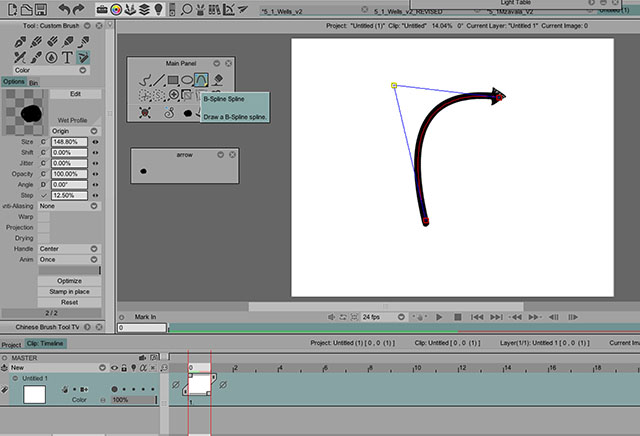

Re: arrows
Draw it with B-Spline tool and you can make precisely curved arrows.

Re: arrows
I guess Peter is using the same technique as Slowtiger, just with the line tool instead of the freehand tool.hilere wrote:Peter, how do you do these technical arrows? Is this something from a later version? I am still on 9.5.
- Posts: 4519
Re: arrows
correct, its a simple two frame animbrush.schwarzgrau wrote:I guess Peter is using the same technique as Slowtiger, just with the line tool instead of the freehand tool.hilere wrote:Peter, how do you do these technical arrows? Is this something from a later version? I am still on 9.5.
