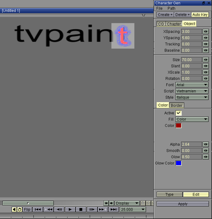

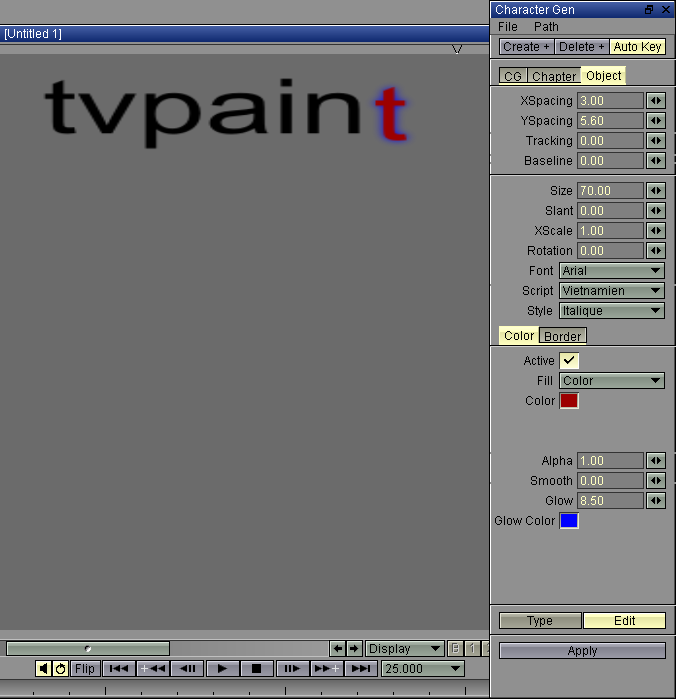

- how can I set the font/color/glow/... option settings on an entire word (or) paragraph, in other words, how can I select the part I want to be active and to be modified? (see pict.1, only the last letter is affected).
- how does work the alpha setting? and why a decimal value?
(I think a 0>255 or 0>100% would be more intuitive), because like this,
I got weird render... (see pict.2)

ZigOtto wrote: 2 questions to start :
Zig, you already get how to type a text : Just press the Type button at the bottom of the panel.
If you want to set the font/color/glow/, make sure that you have selected the text you want to set using either your mouse or your keyboard using Shift + Arrows/Home/End (like in a traditional Text editor).
Then press the Edit button at the bottom to set the options as you wish.
ZigOtto wrote: - how does work the alpha setting? and why a decimal value?
The alpha setting works with the Glow parameter and it's true, a value between 0 and 100% must more intuitive.

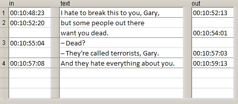

-a subtitel option
where you can set in and outpoints for lines (see image)
either by manually entering framenumbers or smpt code
or (even better) catching those numbers 'on the fly' i.e. while playing the clip each keystroke records the in-point/out-point/in-point/out-point...etc

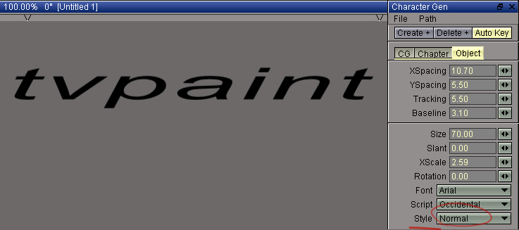

ah, also a little bug :
style: Normal/Italique seem to be inverted. (see pict.)
