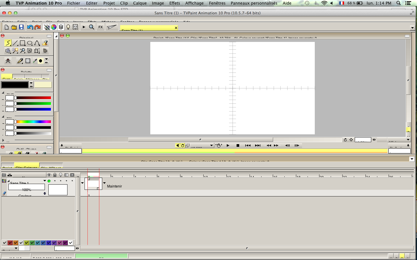

I have issue with my tvpaint
all my menus are truncated (cf screenshot)
I run tvpaint 10.5.7 on a macbook air (OSX 10.9.5)
I've reinstalling but nothing has changed.
Has anyone got this problem before?

Hello !
Usually, this bug happens when Arial font is missing. You should re-install this font and reset your TVPAINT config (Finder > Go to menu > hold "alt" to display the Library > delete "TVPaint Animation 10 Pro" folder).

Hello !
Thank you! It was my colleague who call yesterday. the problem is fixed, she reinstalled the arial font and now it's working very well.
Thank you again.
Have a nice day.
