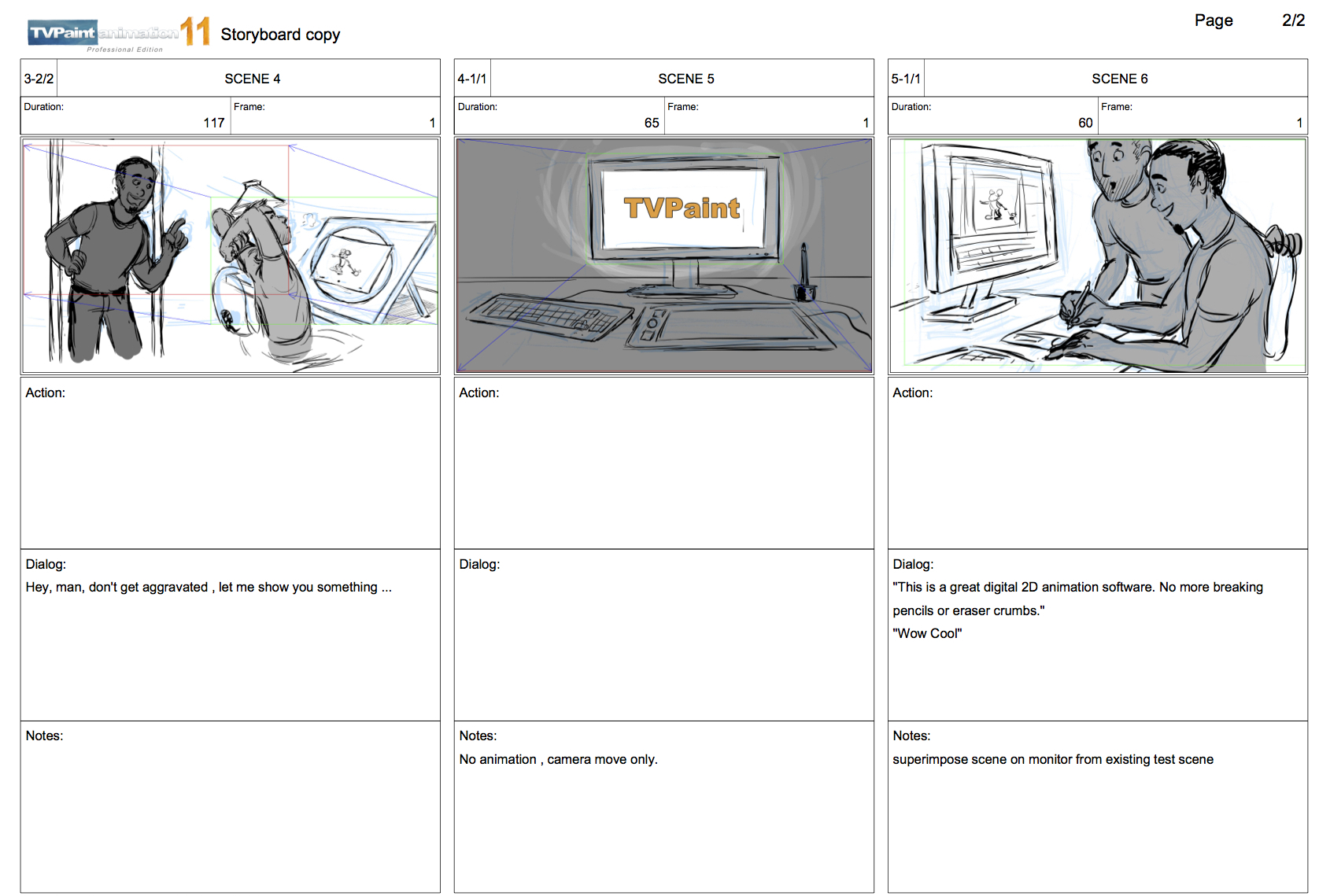

Keep in mind you can PUBLISH your storyboard to a PDF .
File menu > Publish ... . http://www.tvpaint.com/doc/tvp11/index. ... ublish-pdf" onclick="window.open(this.href);return false;
Here's an example of what it looks like in PDF format -
(click on image to see it larger)

Thanks for the detailled answer David
I just want to add that one can decide to keep the "dialogue" box only when publishing the PDF.
