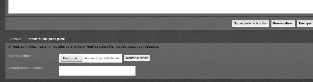

You can use the "attach a file" tab when writing your message, to add an image.(I couldn't find how to embed this image... the IMG button didn't worked... It's hosted on google drive, so may be there is some security setting I couldn't find ?)
- Posts: 27
- Joined: 01 Feb 2015, 04:04
Re: instance handles disapears on long time range
I had not noticed that, useful ! I edited the post.Fabrice wrote: You can use the "attach a file" tab when writing your message, to add an image.
