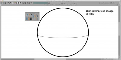

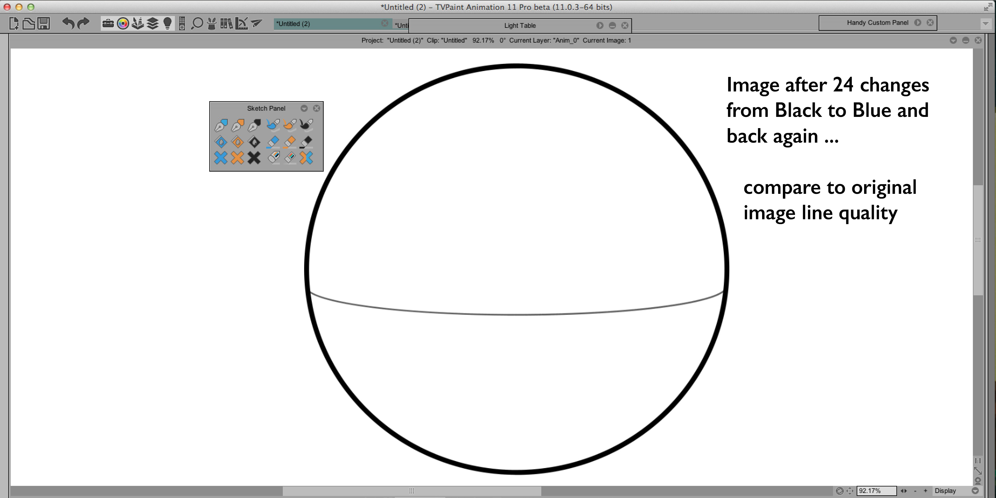

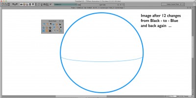

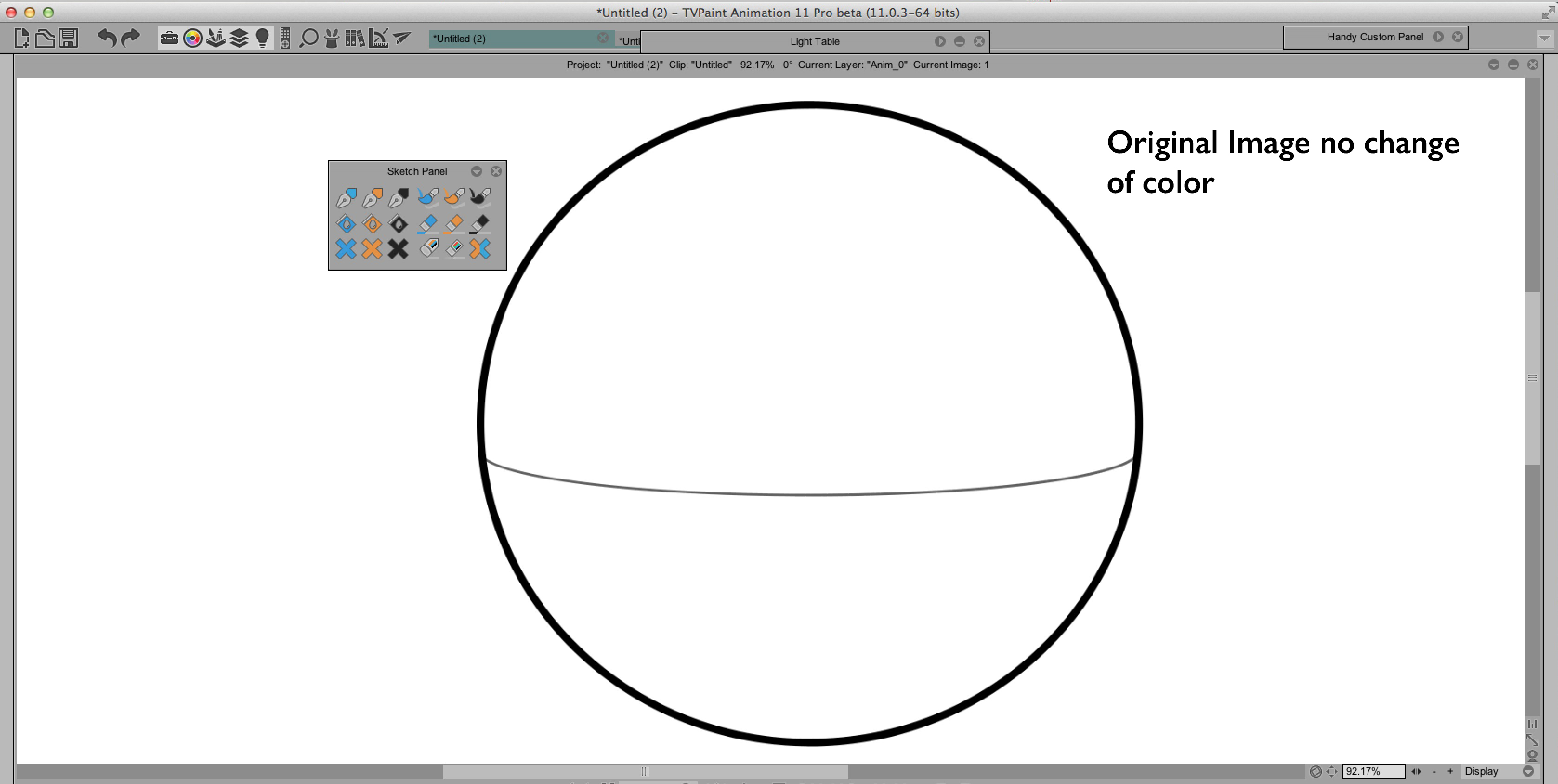

I don't think changing the pixels color from Black to Blue and back to Black with the Sketch Panel buttons is destructive, because no transformation is applied to the pixels , only the color is changed.
The screen shots show the same image : first screen shot is original image , no changes of line color , second screen shot shows the image after 12 changes of line color, third screen shot shows image after 24 changes of line color from Black to Blue to Black .
[click images to see them full size]
