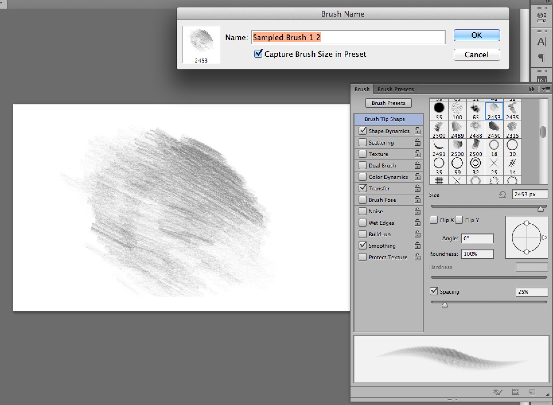

When you say "post an image of the result you want to achieve" do you mean post an image of the Photoshop brush , like this ? --

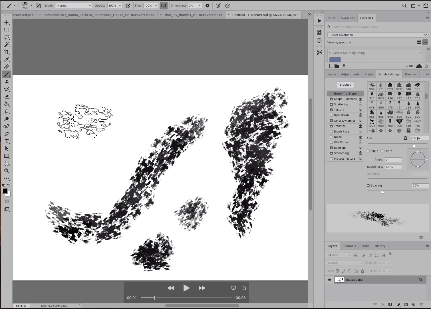

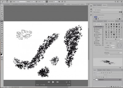

Is there an easy way to get an image of the original stamp/pattern of a Photoshop brush ? When I try to take a screen capture , the brush pattern disappears and is replaced by
the mouse cursor to draw the boundaries for the screen capture. The only way I could do it was to make a screen capture movie using Quicktime , then grab a frame from the screen
capture movie which shows the original stamp/pattern of the brush. (see below)

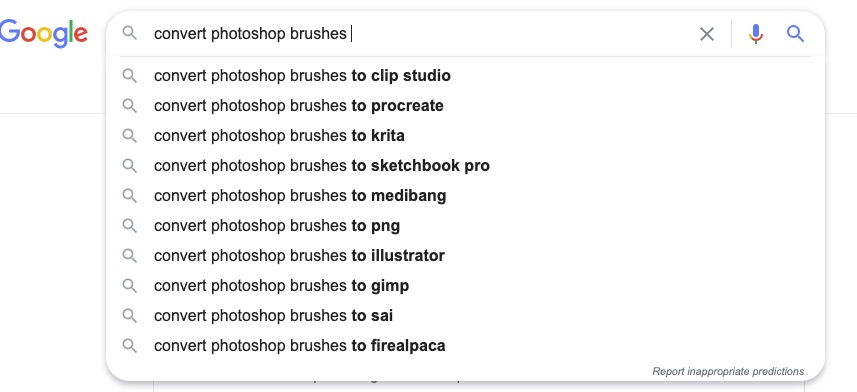

I noticed that if I do a search for "Convert Photoshop Brushes to" I get results for Convert Photoshop Brushes to Sketchbook , Clip Studio, ProCreate, SAI , Krita, GIMP, etc. , so it seems that people are doing this for other apps.
Screen Shot 2021-01-21 at 12.29.02 PM.jpg (60.67 KiB) Viewed 22420 times
