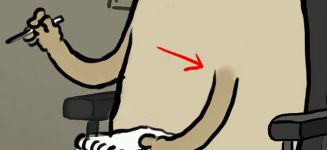

This is excellent. Thank you so much, Jet. So when the source is set to Display, it means that it treats all visible layers as one, which makes this work, so that's great. It seems obvious now, but I hadn't realized this. One other small question. Is it possible to fill an area so that it has a soft edge for part of it, or does this just have to be done by hand? Here's what I am after where the arm connects to the body.

Tricky! I'd perhaps do it like this but there must be a much easier way to do it, since I'm a cel shade man it's just a shot in the dark. Probably smudging by hand is easier.David_Fine wrote:Is it possible to fill an area so that it has a soft edge for part of it, or does this just have to be done by hand? Here's what I am after where the arm connects to the body.
Create two color levels, one is for the base color and the other is for the arm (or shadow), this allows the arm level to use opacity over the base color.

I would use a basic blur FXDavid_Fine wrote:This is excellent. Thank you so much, Jet. So when the source is set to Display, it means that it treats all visible layers as one, which makes this work, so that's great. It seems obvious now, but I hadn't realized this. One other small question. Is it possible to fill an area so that it has a soft edge for part of it, or does this just have to be done by hand? Here's what I am after where the arm connects to the body.

Nathan is right, even if I would like to have better options or FX to do so (not only to blur between two colors, it should be for other kind of results too)
