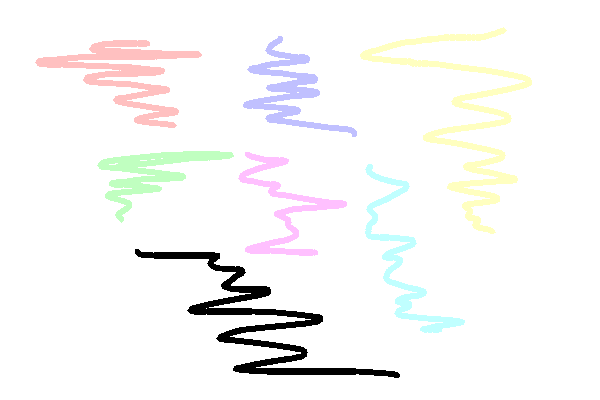

Hello everyone !
For those of you that like Japanese animation, here is a new Sketch panel right for you ! (More colors, but they are not anti-aliased)
You can still add the AA in the 11.0.3 with the Stylise > Anti-Aliasing FX.
SketchPanel-noAA.tvpx
(2.27 MiB) Downloaded 501 times
EDIT (Fabrice) : better version with pastel colors !!
Sketch_Panel_Pastel_Japan.tvpx
(2.31 MiB) Downloaded 468 times
