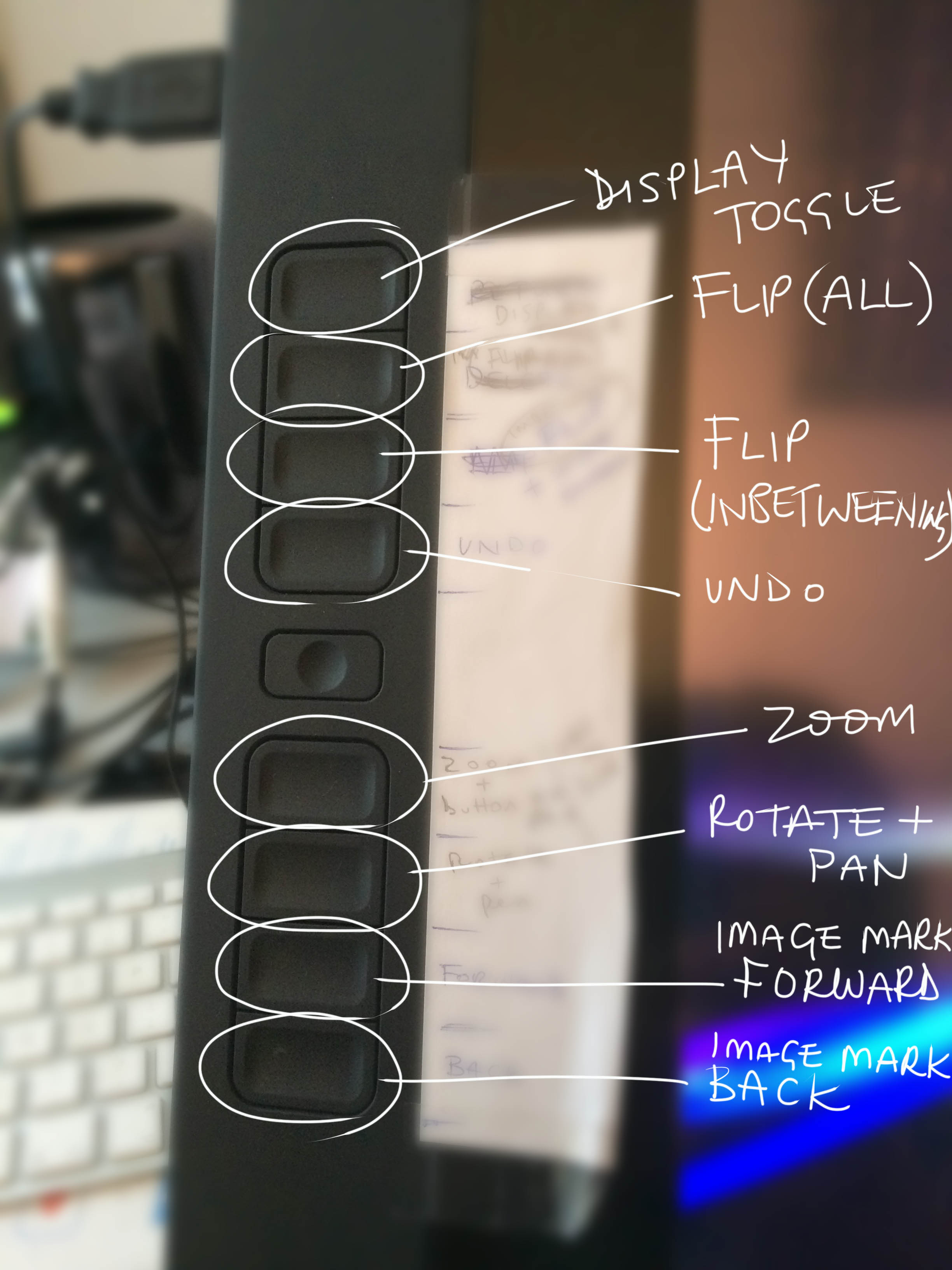

Attached is how I have my keys set up. Only on the left so far. From top to bottom it is...
- Display toggle ( to flick between the screens)
- Flip all
- Flip in-betweening
- UNDO
- Zoom
- Rotate and Pan
- Image mark FORWARD
- Image mark BACK

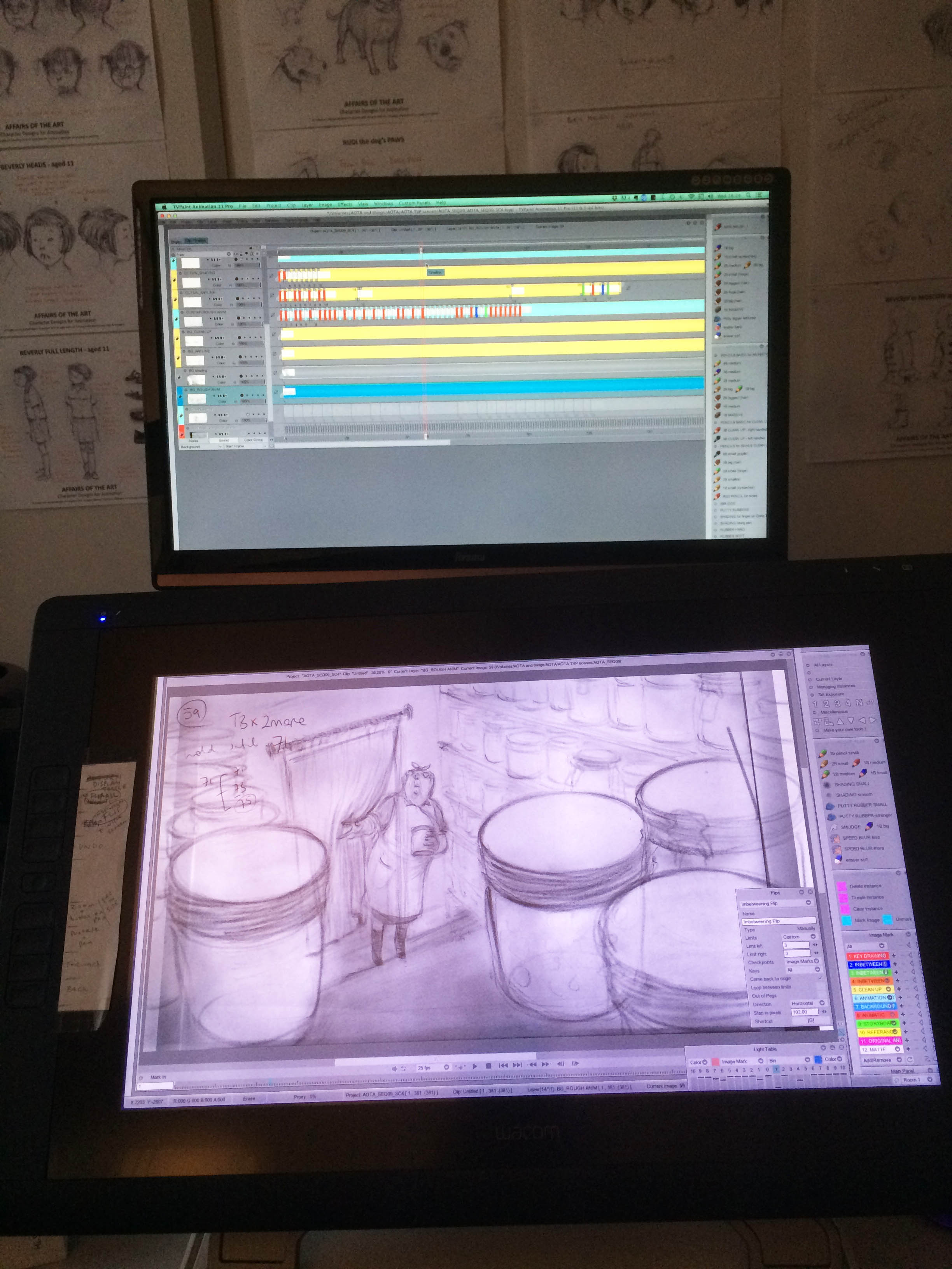

It might be interesting for you to see how I lay out the project too. I stretch the project across both screens. At the moment I have the monitor above the Cintiq as there is less side to side head turns!
Hope the above helps - it certainly would have helped me!!!
