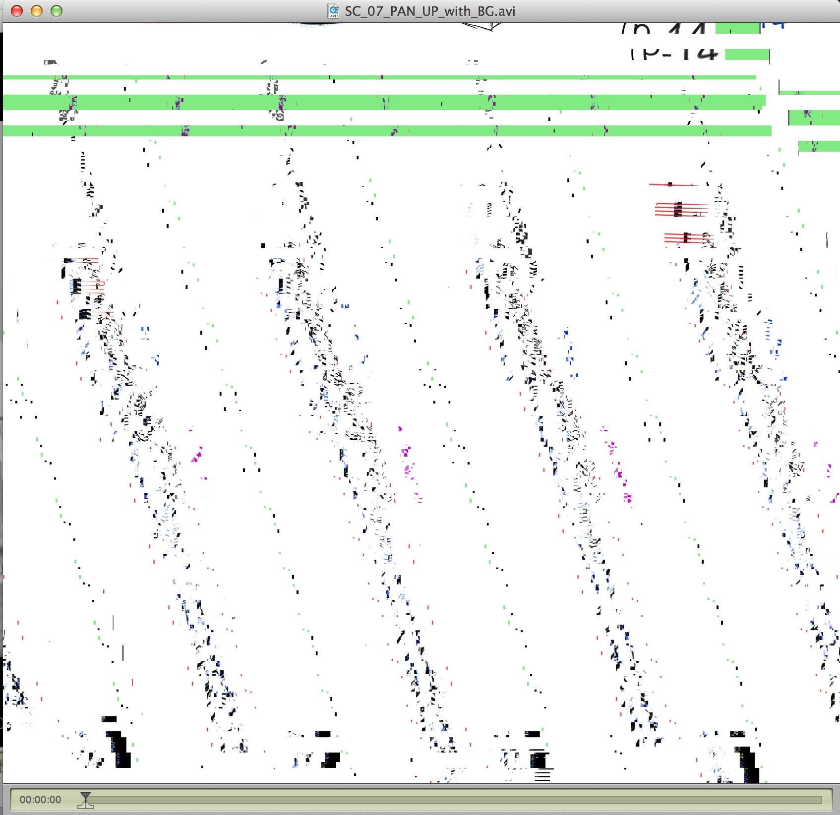

I have a TVPaint project sized at 7000 x 6363 (for a very long zoom-out ) .
When I try to export it to .AVI or .MOV it won't export .
With .MOV (FFMpeg) I get all black frames .
With .AVI (Motion JPEG , 75% compression quality) I get distorted images of random "noise" as shown :

The original project size is 7000 x 6363 , three layers, 229 frames . When I reduced the output size from 7K to 4K I was able to export a .mov file . 2K also worked fine. Tried it at 5K ,but the problem reoccured . So it seems to be an issue of trying to export a mov or avi file over 4K .
