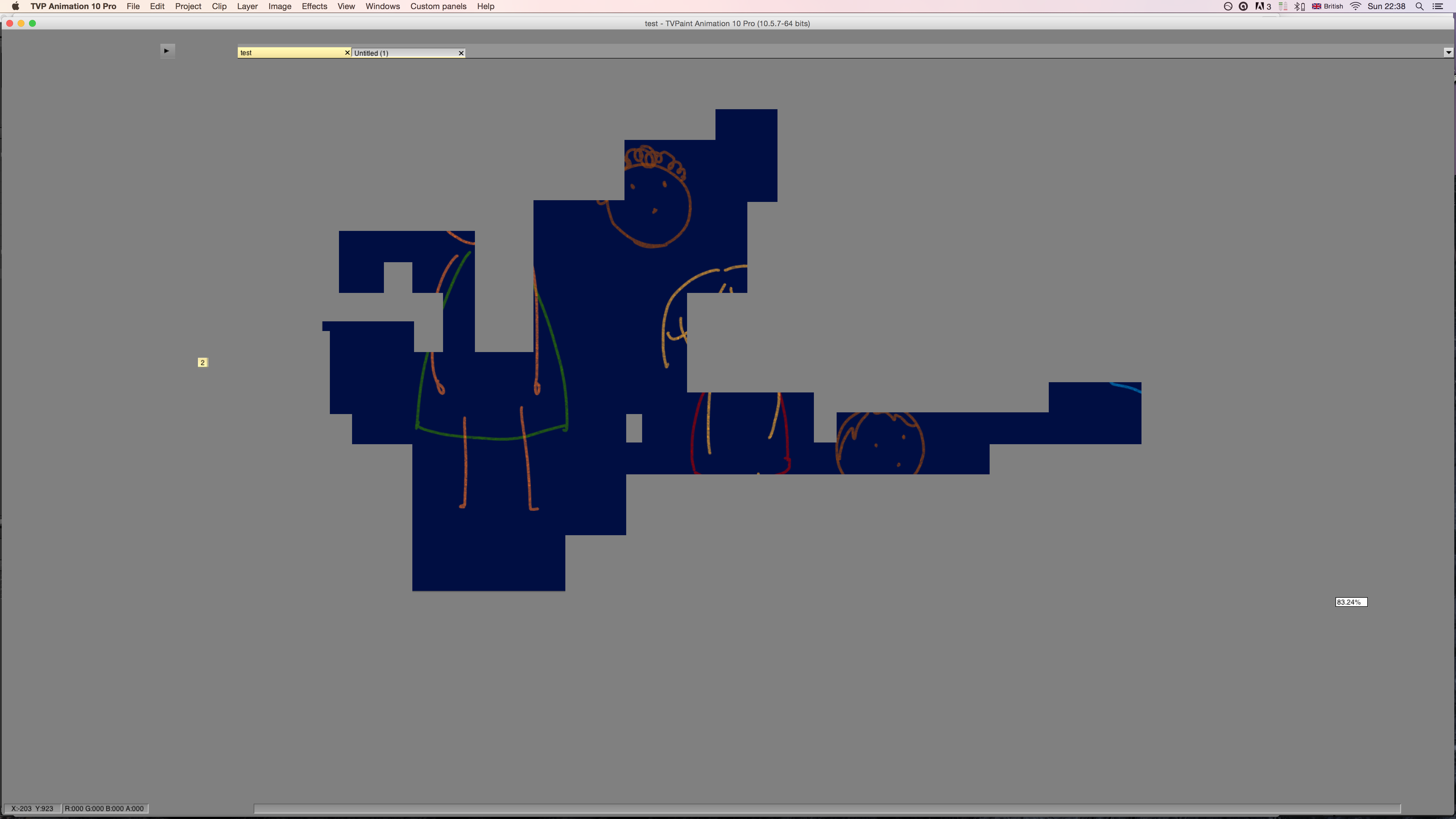

Could you send a screenshot ? It would be more helpful and at least, we would really now if the issue you have is the same as the one we are thinking of.
Re: Glitch makes me restarts TVP every 4min! Help please
Thanks for following this up Elodie, much appreciated. Here is a screenshot...
Hmm... So that really is the issue we were thinking of....
That's weird, you are not supposed to have this. Are you sure you did not installed / change anything recently (since the beginning of the glitch, I mean) ?
