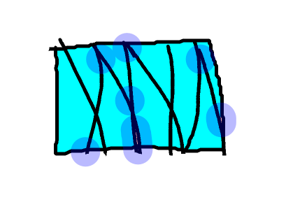

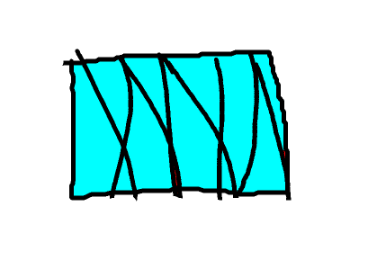

Maybe there is no need to know what I am doing right now, but I will explain.
This aliased image has tiny holes and it's hard to find, so I make a new layer and fill those holes using Filled Rectangle with Fill inside option checked.
And here is the result
Those holes are filled with fresh red color, but It's still hard to find exactly where holes are.

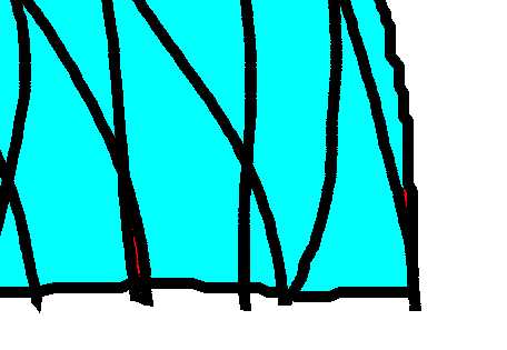

So I add effect "Stylize - Border" to the new layer, and finally it gets easy to find exact location of those holes.
I always do this kinda things to find holes in other applications which has border effects.
Right now this is the best way for me.
