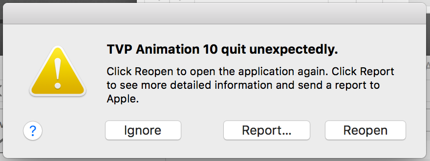

I've been working with TVP10 for a while now and suddenly today it stopped running!
It simply will not start up and I get the message "TVP Animation 10 quit unexpectedly" with the option to "Ignore", "Report..." or "Reopen".
Screen Shot 2022-02-07 at 21.33.47.png (63.92 KiB) Viewed 5388 times
When I select "Ignore", the software won't open and for, "Reopen" I get the same "TVP Animation 10 quit unexpectedly" message again.

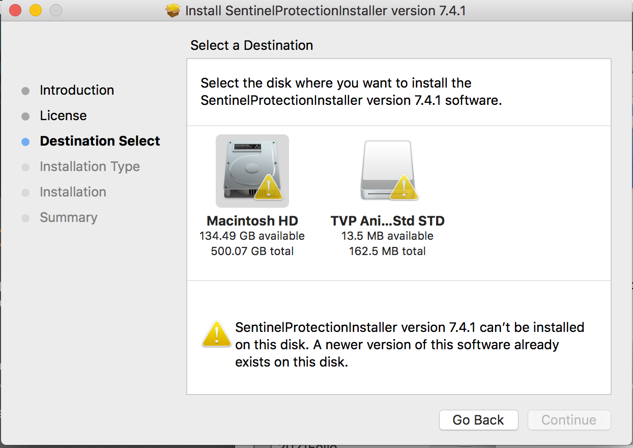

I have tried deleting and reinstalling the software a few times, but ended up with the same result.
When reinstalling, I was unable to install SentinelProtectionInstaller 7.4.1 due to "A newer version of this software already exists on the disk".
I can see that I have SentinelProtectionInstaller 7.4.2 on my computer, but I don't seem to be able to uninstall this.
However, I'm mot sure if this is the reason I can't run the software all of a sudden.

Hello, you could try resetting your TVPaint by deleting its configuration file.
It is located in Library > tvp animation 10 > default > config.ini (name of the file you have to delete).
But the system Library folder is hidden by default on MacOS, you can follow this guide to reveal it:
https://www.noterepeat.com/articles/how ... ry-folders

Thank you!!
For some odd reason, the problem just fixed itself this morning!
I simply disconnected my cintiq and it worked!
Perhaps it had something to do with the graphics card....?
Anyway, thank you for the tip and if I have a problem next time I know I can try deleting the config file!!
Re: TVPaint10, suddenly not working (Mac OS10.13.6)
Posted: 08 Feb 2022, 15:25
by Dean
Handling multiple monitors has always been complex on MacOS, maybe your TVPaint 10 had choice paralysis regarding where to display itself when running, so it crashed
