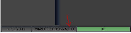

not totally clear to me, but haven't you the RGBA values in your infobar when you roll your mouse (cursor) over the canvas ?
if you need the alpha info of a single layer, hide all others.

It looks like it only shows the alpha of the selected layer? No need to hide the others.

ZigOtto wrote:not totally clear to me, but haven't you the RGBA values in your infobar when you roll your mouse (cursor) over the canvas ?
wow Thanks Zig,
a clear case of Doh!
