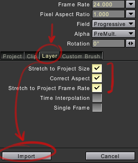

1.) your TVP Project size is 1920 x 1080 .
2.) But your original scans are larger than 1920 x 1080 (so let's say your scans are oversized at something like 2205 x 1240)
3.) When you import the scans into TVP using the Import Footage window the project readjusts itself to the larger scanned paper size (2205 x 1240 in my imagined example) instead of coming in at your desired project size 1920 x 1080 .
Is that the case ?
It sounds like in the Import Footage you are bringing the scans in as a Project instead of bringing them in as a Layer of the existing project.
Make sure that you have the Import Footage set to Layer.
