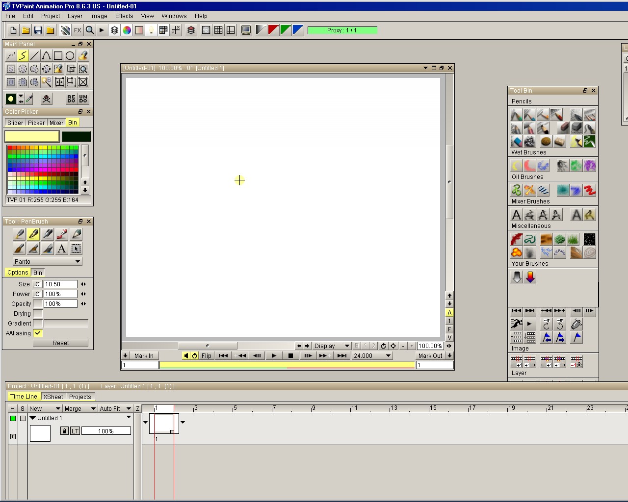

[img[/img]
1. I open TVP and it looks like this:

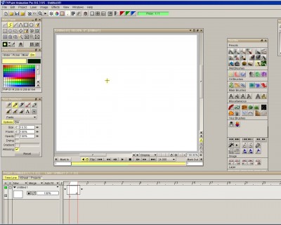

Here are my preferences...

Chris, you are able to draw, even if the proxy is calculating...
But if you don't want any proxy :Windows > Display settings > and disable the proxy.

No, I am not able to draw when the proxy is calculating. TVP locks up.
But I did windows>display and disabled the proxy. Now it is working.
