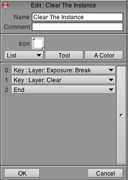

ZigOtto wrote: can you check your "white square" button by RMB-edit ...
the embedded command should be
Code: Select all
tv_cmd heads tv_clear
ok, I checked that and my panel said this:
Bildschirmfoto 2014-04-13 um 13.17.15.png (17.24 KiB) Viewed 22047 times
so I made a new button with your code and it worked, thank you!
I am actually really scared of code :oops: because I think I could break the whole program or the program will run slower if I do something wrong.
I misunderstood you and thought you told me to assign the code to a custom brush not button.Now I tried your paste in place solution but the "Recompute Exposures" seems to get rid of the selected instances. When I hit the button the instances disappear.
