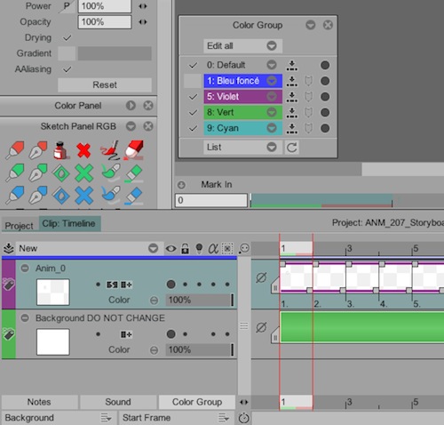

Is it because the Color Group BLUE has been unchecked (hidden) in the Color Groups panel ?
Color Groups.jpg (68.78 KiB) Viewed 9786 times

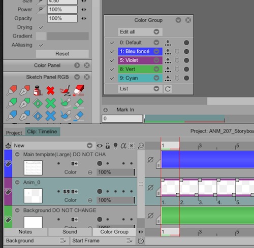

If the BLUE color group has been unchecked then it will only show as a thin blue line and won't show again until you check the BLUE color group again .
Color Grop Blue HIDDEN.jpg (63.99 KiB) Viewed 9786 times
